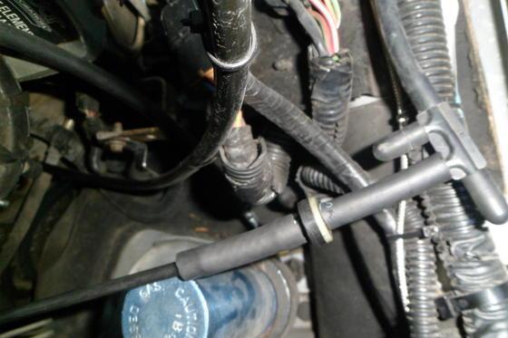

    Here is the finished repair:

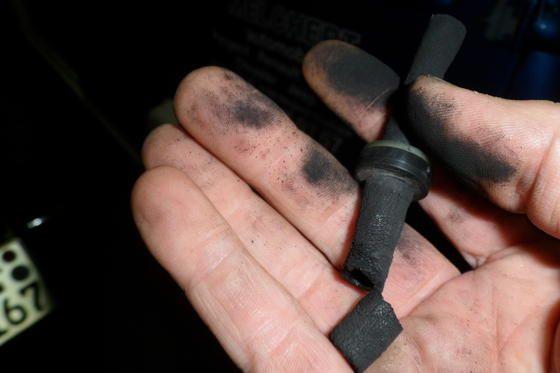

    Oh, here is the offending part:

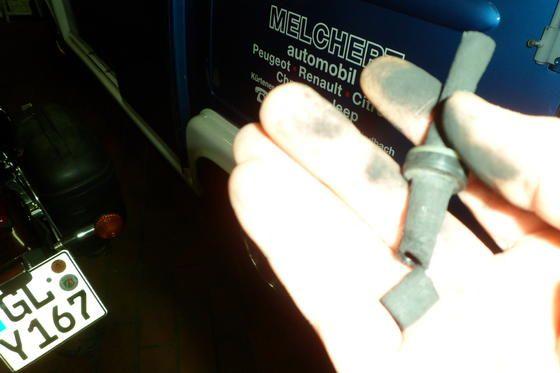

    Not really, but really, proof that the solution for the Dodge Ram occurred at Melchert's . . Thanks Stefan. . .
    Anyway, the almost open leak from the vacuum pump was causing the excessive smoking. Thanks TDR, and Melchert AutomobilJonathan.

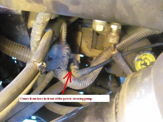

    Quote Originally Posted by B. G. Smith View Post
    I was wondering the same thing. I'm sure someone will let us know but my guess is that the pump discharges into the crankcase so a bad leak would cause a greater air flow into the engine base. bg
    That's right. If you look behind the pump, there is a braided line that goes to the crankcase, that is the oil feed. However, FWIU, the exhaust from the pump goes into the crankcase, I guess with the 'drain' oil? Normally the system is 'closed. ' When there is a vacuum leak, all of the 'exhaust' from the pump ends up in the crankcase, adding to the volume of air already being displaced by the descending pistons. . . increasing oil consumption, as well as blowing a ton of air and oil out of the breather. . . HTH Jonathan
