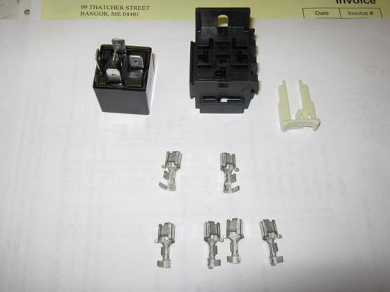

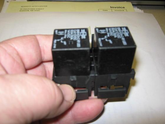

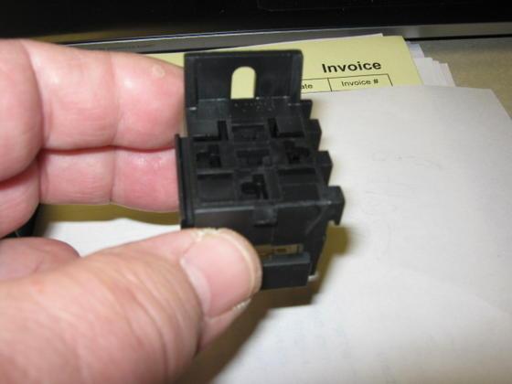

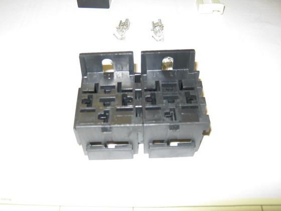

    Kit contains the holder, relay, wire ends and terminal lock for the holder.
    Another neat feature is that they will nest, you can hook several together using the built in tracks on the side of each holder.
    Very heavy duty, quality stuff. No flimsy light duty junk here.
    Relays are 50/30 amp rated.
