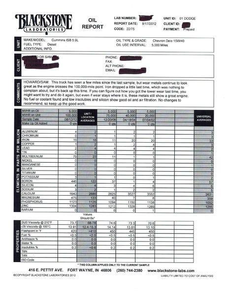

    Here is my blackstone oil sheet for my truck since it was new. K & N's work just fine for me, it has had one or an AFE since about day 100. . . . . silicone levels are well below the average.

    Ram4Sam your results are not normal, and simple searching will show the destruction they cause. I am not sure why you have good luck, but your showing people atypical results, and hopefully it doesn't lead to them ignorantly purchasing one of the worst filters on the market.

    Well He also lives in Redland's not that much dust or dirt if he lived in the Desert I'de tell him he's Crazy but that's up to Him if he want's to run a Junk air filter . You can lead a Horse to water but I'll be Darn'd if you can make it drink .
    Real world testing versus controlled lab testing. . . . . . .
