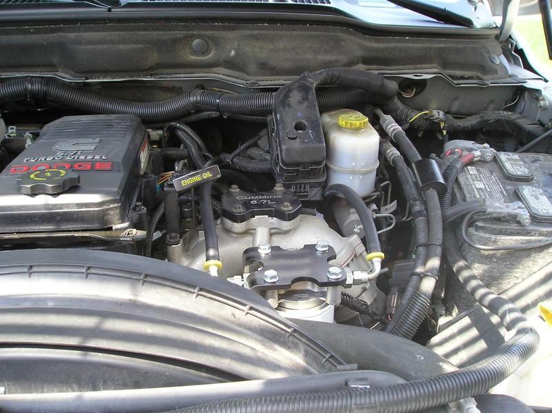

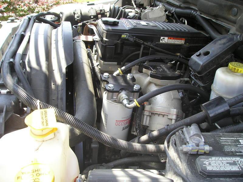

    This should work if you are just looking for additional filtration. Glacier Diesel‘s MK-2 Big Line Kit for the Ram Cummins 6.7L engine. They offer two different version one for the 07.5-09 and the other for 10-12 MY; both sell for $219. They use a Fleetgaurd filter part number FF5320 and will flow at 100GPH with a delta T (pressure drop) of less than 1PSI. This is per the Glacier Diesel Specs on the filter and kit.
    I am using one on my truck after the stock filter and before the CP3 pump, see pictures attached.
    Here is the link if you are interested. http://www.glacierdieselpower.com/de...dept_id=08-003
