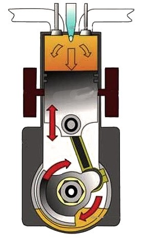

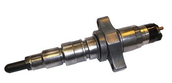

    * Here it is (in the simplest of explanations). The answer to why the diesel engine is more fuel efficient than a gasoline engine.
    The Injection System
    “It’s in the injection system.”
    Rudolf Diesel designed the heat engine to use the injection of fuel at the last moment to ignite the compressed air. Understanding the heart of the diesel, the fuel pumps, is the key to answering the fuel efficiency question.
    The Gasoline Engine
    A gasoline engine is what engineers call “stochiometric.” Stochiometric describes the quantitative relationship between two or more substances, especially in processes involving physical or chemical change. With a gasoline engine there is a stochiometric equation of 14 parts of air to one part of fuel. Remember, always 14:1. (Okay, modern gasoline development has some engines at leaner 16:1 and gasoline direct injection is now widely being used.) Whether at idle or full throttle, the fuel and air are (typically) mixed outside the cylinders in a carburetor or injection manifold, and the mixture is introduced to the combustion chamber via the intake valve, 14:1, always.
    The Diesel Engine
    Fuel and air in the diesel design are not premixed outside the cylinder. Air is taken into the cylinder through the intake valve and compressed to make heat. Diesel fuel is injected near the top of the piston’s stroke in an amount or ratio corresponding to the load on the engine. At idle the air-to-fuel ratio can be as high as 85:1 or 100:1. At full load the diesel still boasts a miserly 25:1 or 30:1 ratio! It is in the injection system where we find the key to the diesel’s fuel mileage superiority.
